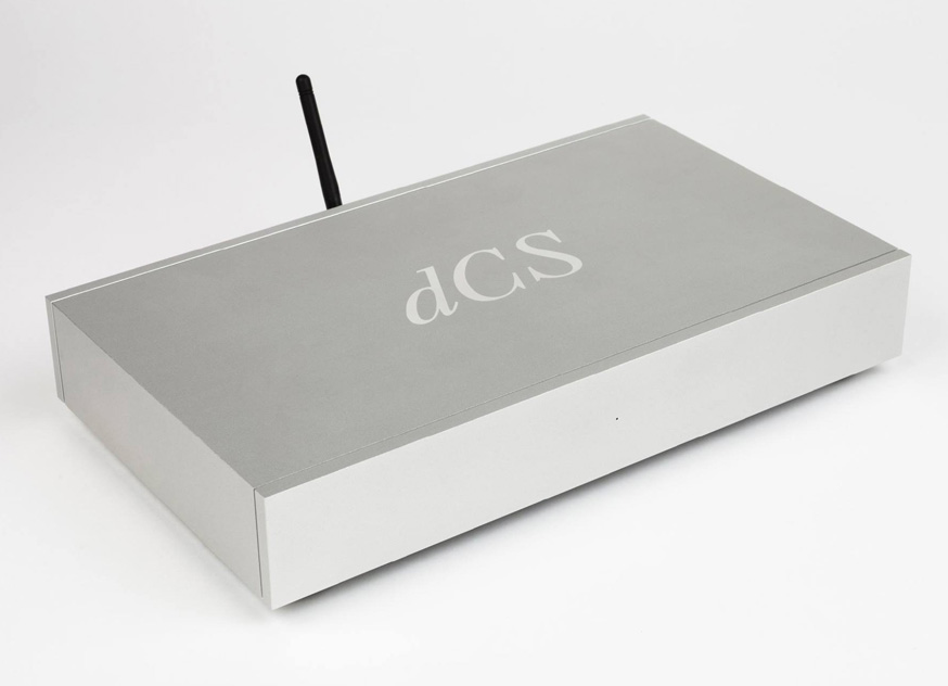

Technical Specifications
- Type
Network Bridge
- Colour
Silver or black
- Dimensions
360mm/14.2” wide x 245mm/9.65” deep x 67mm/2.65” high. Allow extra depth for cable connectors.
- Weight
4.6kg/10.2lbs.

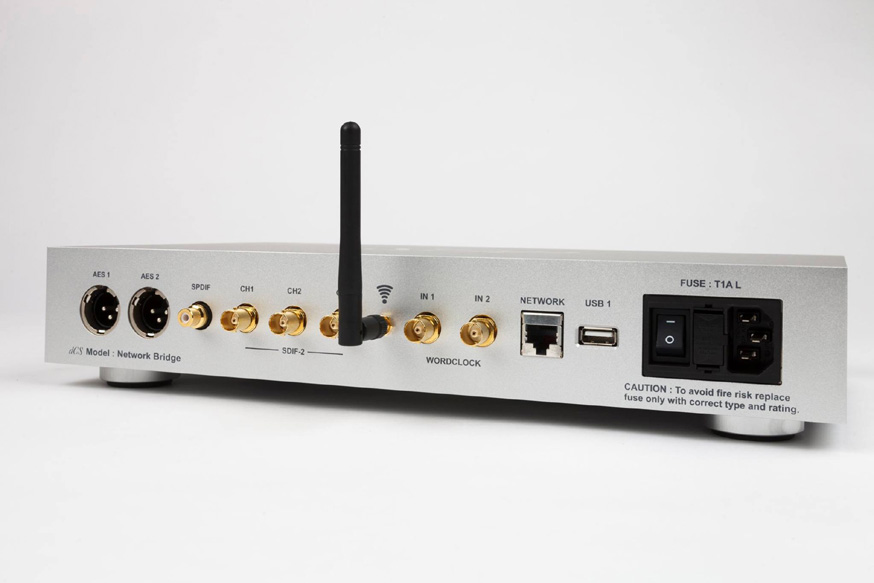

- Digital Inputs
Network interface on an RJ45 Gigabit Ethernet connector – Acts as a UPnP™ renderer operating in asynchronous mode, streaming digital music from a NAS or local computer over a standard Ethernet network, decoding all major formats. Network and built-in WiFi accept data streamed from an iPod, iPhone or iPad via Apple AirPlay™. Music can be streamed from the internet via Spotify Connect™ or Tidal™, the Network Bridge is Roon™ ready. USB 2.0 high speed interface on type A connector operating in asynchronous mode, streams digital music from external drive.
- Digital Outputs
2x AES/EBU on 3-pin male XLR connectors, each outputs PCM at up to 24 bit 192kS/s or DSD/64 in DoP format. Used as a Dual AES pair, the interface outputs PCM at up to 384kS/s, DSD/64 & DSD/128 in DoP format. 1x SPDIF on 1x RCA Phono connector, outputs PCM at up to 24 bit 192kS/s or DSD/64 in DoP format. 1x SDIF-2 interface on 2x BNC connectors, outputs PCM at up to 24 bit 96kS/s or SDIF-2 DSD/64.
- Worldclock Inputs
2x Word Clock Inputs on 2x BNC connectors, accept standard word clock at 44.1, 48, 88.2, 96, 176.4 or 192kHz. The data rate can be the same as the clock rate or an exact multiple of the clock rate. Sensitive to TTL levels. Word Clock Output on 1x BNC connector, carries Word Clock at the same frequency as the data rate up to 96kHz.
- File Formats
FLAC, AIFF & WAV – up to 24 bit PCM at 44.1, 48, 88.2, 96, 176.4, 192, 352.8 or 384kS/s. ALAC – up to 24 bit PCM at 44.1, 48, 88.2, 96, 176.4 & 192kS/s. AAC, MP3, WMA & OGG – up to 24 bit PCM at 44.1 or 48kS/s. DFF, DSF & DoP – DSD/64 & DSD/128. Apple AirPlay – 44.1 or 48kS/s.
- Conversions
User-selectable down-sampling to match legacy DACs: – 176.4 & 352.8 > 24/176.4 or 24/88.2 – 192 & 384 > 24/192 or 24/96 – DSD/64 & DSD/128 > 24/176.4 or 24/88.2 This feature is set by the Network Bridge App.
- Software Updates
Download and update functionality available via the Network Bridge App.
- Local Control
dCS Network Bridge App for Unit Configuration and Music Playback or UPnP compatible control app.
- Power Supply
Factory set to either 100-120, 220-240V AC, 50/60Hz.
- Power Consumption
6.5W typical, 50W maximum.
