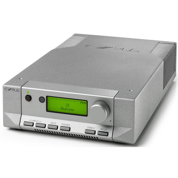

영국 사이러스사의 최신 DAC 입니다.
Technical Information
Many Cyrus owners recollect the impact that the hi-fi industry felt a decade ago when Cyrus launched the Discmaster/Dacmaster/PSX-R combination. The combination set new performance standards for CD replay, featuring leading edge digital technology presented in a unique 4-box format.
The brief for the DAC X+ was to bring this 4-box formula up to date by taking the best DAC technology available today and building a class-leading stereo digital decoder to partner the CDXT SE2 and a pair of PSX-Rs. Adding a separate analogue pre-amplifier into the DAC X+ chassis upgrades the DAC X+ to the DAC XP+ which becomes the control centre for a high-end stereo system.
D/A conversion: At the heart of a quality D/A converter is the circuit that converts the digital source signals to analogue. Careful design of this circuit is essential to retrieve the true dynamics of the source signal and to minimise undesirable artefacts such as noise and distortion. The DAC XP+ achieves this with a two stage upsampling design where all sources are initially upsampled to 192k before analogue conversion by quad high-precision 24-bit converters operating in a fully balanced configuration. The technical specifications endorse the quality of this stage with class-leading performance for THD and noise. The elevated 192k sample rate permits our designers to use far less aggressive analogue filtering techniques to remove undesirable out-of-band digital noise.
Jitter reduction: All audiophiles understand that low jitter is an essential requirement for the clocks and data signals passed within a D/A converter. In the DAC XP+ the sophisticated re-clocking circuit measures the precision of incoming digital signals to determine the quality of the input source. High accuracy sources such as the CD8 SE2 CD player are digitally re-clocked by a close tolerance circuit with triple quartz references. For signals from low accuracy sources such as personal computers the circuit automatically relaxes the re-clocking precision to ensure reliable signal recovery.
Sample rate handling: The DAC XP+ is prepared for the wide range of sample rates available from today’s digital sources and beyond. Group 1 close tolerance performance is available for 32k, 44.1 k, 48k, 64k, 88.2k, 96k, 128k, 176.4k, 192k source material. For sources outside of Group 1 requirements, any sample rate in the range 32k – 192k is accepted. Non-stereo waveforms (surround sound etc.) are identified and suppressed to avoid undesirable digital noise.
Digital output: An optical digital output provides a useful digital feed to send the signal from the selected source to digital recording devices or to a multi-channel surround sound decoder.
Pre-amplifier circuit: The chassis of the DAC XP+ is divided into two entirely separate sections – a DAC X+ digital D/A converter and a fully balanced analogue preamplifier. The preamplifier stage complements the balanced topology of the digital stages perfectly with a balanced input from the internal DAC, balanced volume control and balanced output buffers. The twin analogue inputs of the preamplifier stage enable the DAC XP+ to completely replace the system preamplifier in most systems.
Power supplies: The DAC XP+ power supplies are traditionally built linear designs, with an oversize toroidal power transformer dedicated to each section and entirely separate power regulation for the DAC and preamplifier sections. Two-stage regulation is used for critical stages with remote shunt regulators located within the heart of the audio circuitry.
PSX-R upgrade: In keeping with Cyrus philosophy, the DAC XP+ features connection for the PSX-R off-board power supply to further upgrade the audio performance of the power supply section of the DAC stage.
