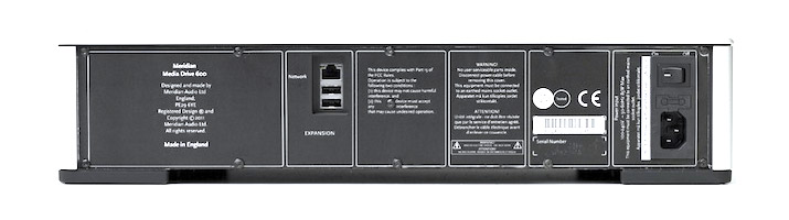

Drive bays |
• Supplied with bays for two up to 2TB drives configured as a RAID 1 system |
Controls |
• Rear panel power switch • Front panel back-lit on/off button |
Indicators |
- Power button LED illuminates blue during startup and shudown; white when operating.
- Six front-panel LEDs as follows (L-R)
- LED 1: Error indicator On=boot failure; flashing=drive mount failure.
- LED 2: Temperature indicator On=product overheating
- LED 3: CPU load indicator On=CPU is running at greater than 80% usage.
- LED 4: RAID drive 1 failure indicator On=RAID marked drive 1 as failed.
- LED 5: RAID drive 2 failure indicator On=RAID marked drive 2 as failed.
- LED 6: Ethernet disconnect indicator On=Ethernet cable is not detected
- If RAID1 and RAID2 LEDs are toggling, one of the drives is being restored to – ie a single new drive has been inserted with an existing working drive.
- If all six LEDs are illuminating sequentially back and forth, the drives are being initialized with a new filesystem, i.e. two new drives have been inserted.
Power |
• Mains operation, universal voltage power supply
Weight |
• 6kg (13.2lb) without drives
Dimensions |
• 440 x 97 (2U) x 350mm (18 x 3.8 x 13.8in) not including rear connectors (WHD) |
Finish |
• Bead-blasted, anodised, black and silver aluminium uniform with Media Source 600.
