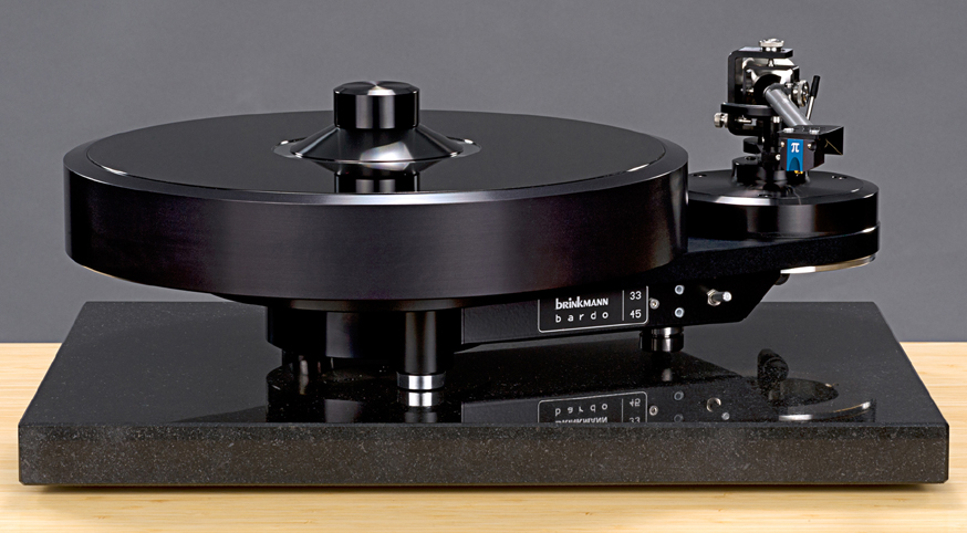

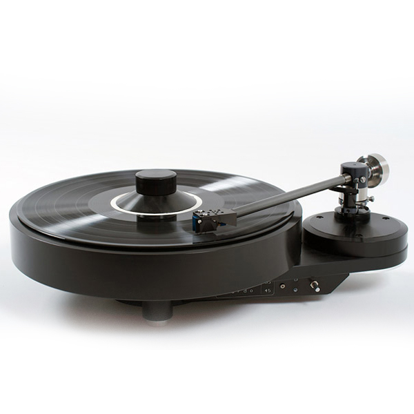

Brinkmann Bardo
Specifications
Drive Platter driven directly by magnetic field; soft proportional control
Power supply External power supply in solid state technology
Bearing Lubricated precision (hydrodynamic) journal bearing, quiet and maintenance-free
Platter Resonance-optimized special aluminum alloy; surface planar polished crystal glass
Chassis 15 mm Duralumin with resonance-optimized geometry
Arm board Movable (rotating) without play for simple and precise tonearm adjustment,
with quick release. Accepts all tonearms between 9 and 12″ as well as several
linear tracking tonearms

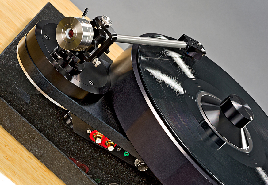

Connectors RCA, XLR or feed-through for tonearms with 5-pin DIN connectors;
DIN connector (3 pin) for umbilical cord of external power supply;
2 mm connector for ground wire
RPM 33 1/3 and 45, selectable by a switch; LED indicator for speed (33 1/3 = green, 45 = red)
Deviation from nominal speed 0.0% (adjustable)
Fine adjustment of speed ± 10% with trim pot
Wow & Flutter 0.07% linear, 0.035% weighted DIN 45507
Speed-up time 12 / 16 seconds (33 1/3 / 45 rpm)
Rumble (noise) -64 dB (test record DIN 45544); -68 dB (measuring adapter)
Dimensions 420 x 320 x 100 mm (w x d x h)
Weight Total 14.8 kg (Chassis 5 kg, Platter 9.8 kg); Power Supply 0.5 kg
