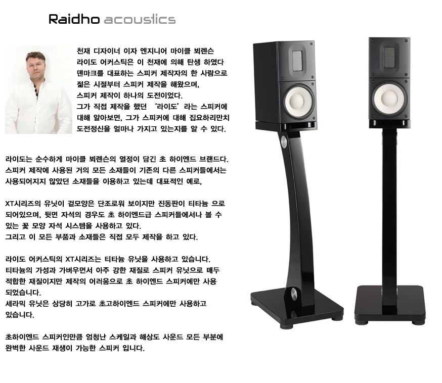

We put the T in the X.   Raidho Acoustics’ speakers, the X-1 and X-1T, are elegant and compact size stand-mount mini monitors.
The speaker is built with the Raidho Ribbon Tweeter and a bass/mid-range driver with ceramic membrane and ceramic/titanium membranes.
The mid-range drivers feature our newly developed neodymium based magnet system in a long throw and low compression design.
The loudspeakers are primarily designed for smaller rooms and can be placed relatively close to the rear wall.
The X-1 and XT-1 are also very ideal for studio work and near-field monitoring.
Size (WxHxD):   145 x 320 x 230 mm
Weight:   8 Kg
Freq. reponse   80 Hz – 50 KHz
Impendance:   >6 ohm
Sensitivity:   85 dB 2.83 V/m
Crossover:   3.5 kHz 1.5
Enclosure:   Vented design Port in front panel
Drive units:   1 sealed ribbon tweeter 1 100 mm titanium driver
Finish:   Black piano and White piano
