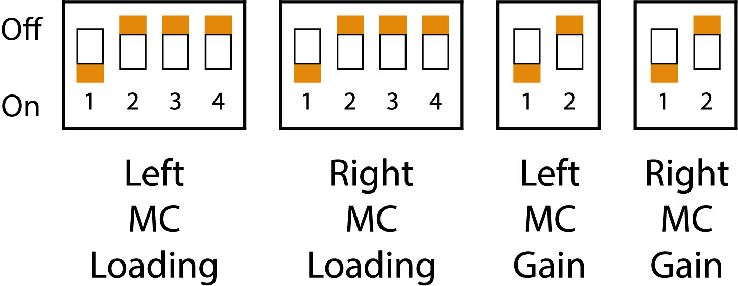

Aria MC dip switch settings for all Rega MC cartridge models
