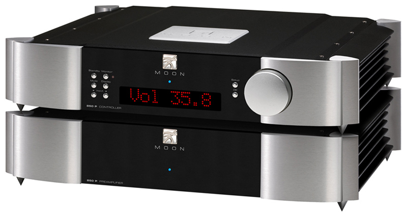

Significant Design Features:
· 2-chassis design with one chassis housing the power supply, digital controller circuitry and
software processing. The other chassis contains the audio circuitry
The preamplifier”s audio section is located on its own dedicated circuit board, which is mounted
with our M-Octave Damping system
Custom proprietary toroidal transformer design with lower magnetic, electrical and thermal
loss, yielding an improved power transfer and lower regulation factor. The result is increased
current speed and better dynamics
A dual-mono oversized power supply features 6 stages of DC voltage regulation and extensive
choke filtering
M-Ray volume control based on the R-2R resistor array configuration using metal film surface
mount resistors with 0.1% tolerances, resulting in no sonic degradation of the audio signal,
regardless of the selected volume setting
M-Lock for “user selectable” maximum volume setting lock-out for each line input
Power supply voltage regulation includes i²DCf (Independent Inductive DC Filtering); There is
one inductor dedicated to each integrated circuit type component (DAC, Op-Amp, etc.) in the
audio circuit’s signal path – 40 stages in all
“Gain offset” for each individual line input with a ±10dB range
Each line input is fully configurable to be “home-theater ready”, where the gain section of the
850P is bypassed
530 individual volume steps in 1dB and 0.1dB increments

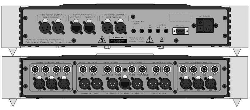

RS-232 port for (i) full unsolicited bidirectional feedback and (ii) firmware updates
12 Volt trigger outputs for remote operation
IR input for external control
SimLink controller port for 2-way communications with other compatible MOON components
An exceptionally short signal path measuring less than 8 inches in length from the rear panel”s
input to output connectors, yielding a much faster transient response
Fully differential, no global feedback circuit topology, using absolutely no capacitors anywhere
in the audio signal path
4-Layer PCB’s with pure copper tracings for a much shorter signal path; This results in
greater sonic accuracy and a dramatically improved signal-to-noise ratio
Ultra rigid chassis construction to minimize the effects of external vibrations
Accurate matching of the very finest quality electronic components in a symmetrical circuit design
Improved reliabilty through the elimination of moving parts
Includes FRM-3 remote control.
